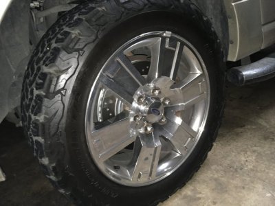

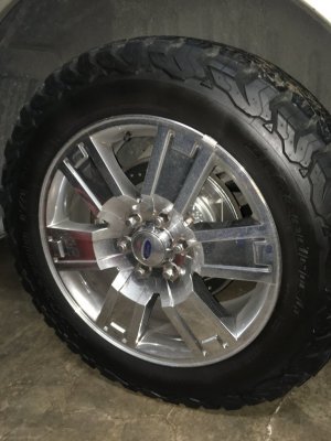

I installed a set of Power Stop Z36 rotors and pads (part #K4109-36) on my 2008 Expedition Eddie Bauer last weekend. I did the fronts and rears. Only had them on my truck for a week but love them so far. They look really cool behind my factory 20” chrome wheels and stop the truck really well...noticeably better than the stock set I took off.
We have a 5000# travel trailer, haven’t pulled it yet with the new brakes installed but looking forward to seeing how they stop the extra load.
After I replaced them, I bled the brakes as a precaution, and followed the recommended break-in procedure. Hopefully doing that will prevent any long term problems.
Got a great deal for the set on eBay, paid $350 shipped for the set a few months back.
I installed the Power Stop Evolution Z23 set on my wife’s 2012 Kia Sorento about 6 months ago and so far they have held up well. Dust doesn’t seem to be too much of an issue, and they look cool behind the black aftermarket wheels on her car too. Power Stop seems to make a good product, IMO.
Best of luck...while I can’t provide any long term observations yet, I am happy with them so far.
