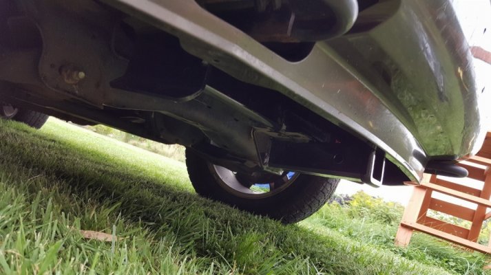

I ended up getting the 31368 and it was exactly what I was looking for. It does not hang down really low, and also does not protrude out the front of the vehicle.

Does the bumper lip flex upward enough to use the hitch or will you have to cut it ?

In my specific install I have no problem pushing the bumper up slightly to clear the hitch. That is also one of the reasons I decided not to cut my bumper either.
