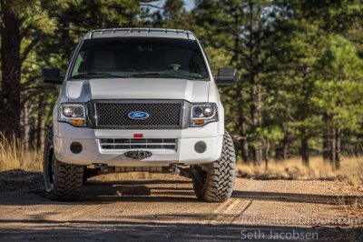

We picked up our 07 Expedition about 1 month ago mostly stock. We named it Aspen. We are known for our Lexus GX470 that we built, but we needed a bigger vehicle to haul more and sleep inside when needed. I have been in garage getting it ready for remote Overland travel. Been replacing anything that might let us down in the middle of nowhere. So far I have got this done. Lots more to come
Falken 35 inch mud terrain tires (5)
Rear gear oil changed 75-140 full synthetic with friction modifier 4 oz # xl3
Front gear oil changed and drain plug installed 80-90
Transfer case oil changed mercon 5
Power steering fluid flushed mercon 5
Transmission fluid changed Mercon LV fluid
Transmission filter FT-171, 7L1Z-7A098-A
Drive belt Napa #061031, 6PK2618
Spark plugs autolite HT15
Fuel filter Ford FG-1036
Coolant changed motor craft #VC-7-B gold antifreeze
Top coolant hose Napa #16240
Bottom coolant hose KM-5028
Oil changed Motorcraft 5W-20, Motorcraft filter # FL820S
Thermostat. Hanged RT-1234 and gasket RG-571-
New rear shaft u joints and balance
Air filter changed Motorcraft #FA-1883
Bled brakes
Rancho rear struts RS999941 RS999926
Changed all coolant hoses
Water pump # PW-494
Fan clutch YB-3074
Drive belt idlers #YS-253 (2)
Drive belt tensioner # BT-61
Alternator 250 AMP high output
Cleaned MAF
Installed new headlight assembly from e-bay
H1 bulbs on high and low beam, Philips crystal vision ultra, CVB2 , xenon look 55 watt
Replaced heater temp mixer, # YH-1873 / 7L1Z-19E616-C
Installed Hidden winch plate #HWCH002FD 09-14 F-150 magnum innovative creations
COME UP 12,000 winch installed
Fuel Pump PFS-514
Fuel lines from tank to filter replaced #8L1Z=0J337-A
Synergy hot water shower heat exchanger installed
Gates bent hose #19628 was used in the shower install
Factor 55 Ultra Hook and HitchLink 2.0
