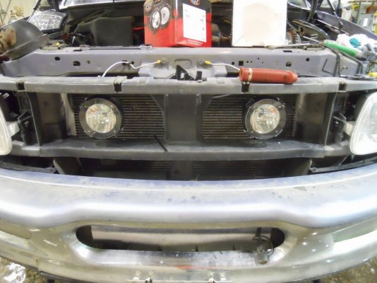

I have 2 Hella Black Magics on the front of my truck. I used a simple 20 amp relay to power the lights. I ran the wire through the grommet in the firewall that is next to the steering column. You can punch a hole in that and run the wire through that.
As for where I mounted the switch, I mounted the switch to the left of the steering column (next to my e-fan status lights). I used a lighted switch for the lights. The lights are powered from the fuse box under the hood. Granted, I did the power the hard way by adding a circuit into the factory fuse box. Unless you are wanting to do things the hard way, I would look at doing things another way. The only advantage is that it results in a very clean install
As for how I mounted the lights, I found a support in the bumper on each side (pretty much at the point where the vertical support is between the grille and the headlights) and drilled a hole there to mount the lights to.

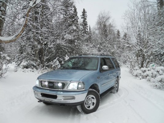

mount behind the grill. looks really clean. put 2 or 4. ive seen 5. still dont know how that middle one was mounted.
