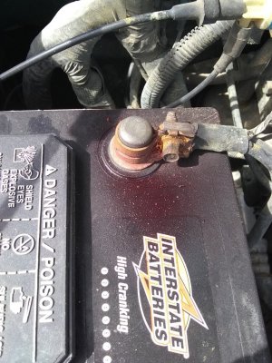

This afternoon I noticed my car wouldn't turn over at all, even though the lights etc came on. Gave it a minute, tried again, and it turned over normally. Dashboard indicator showed the battery as OK.
Popped the hood and saw reddish liquid surrounding the battery terminals (see pic).
Is this battery about to explode or something? Am I viewing something normal? Is it just the anti-corrosion spray my auto shop added a few months back?

No, it's not going to explode. Why not go by the shop or interstate battery, and let them test the battery, and electrical system. That's your jump off point. Get back to us, we'll go from there.

If they are low use only bottle, not tap water. Still have the battery load tested, depending on age, my have a weak cell. When your SUV started the second time, did it crank over fast or slow? When my starter went out 2 years ago, it had symptoms of a failing battery. 2 days later my starter took a dirt nap, and never recovered.

The red looks like a spray all the dealers in my area use. Its keeps corrosion from forming on the terminals and can be bought at any parts store. Don't remember the name for it though

Need distilled or deionized water, not bottled water. Most of that "bottled water" people buy to drink is filtered water, some of it is actually tap water in a bottle sometimes filtered. If carbon filtered that's better. Distilled or deionized water labelled as such is best.
The red is protective goo like MrGixer said.

Did not know that about bottled water. As far as the red stuff, it's just called battery terminal protector. Personally, the best thing I've found are those red and green felt washers that go under the terminals. I've been using them for going on 30 years now, and my battery stays clean as new.

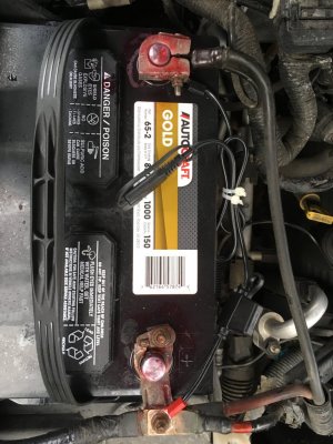

This pic is a new batt just put in and the dude sprayed it with red goo. The motorcraft batt I had put in by ford dealer they sprayed not only the batt terminals , also spray ground contacts on the wall.
I got that battery on the battery tender at home while I'm in Colorado.
