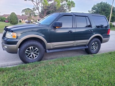

I didn't like the rake of the 3/2 either. I bought a set of aluminum wheel spacers 1/4" thick, drilled holes and placed on top of the rear struts. That provided just over 3/8" lift to the rear and made all the difference in visual appeal. Since the Daystar rear spacer is a spring spacer and not a strut spacer, I was comfortable adding the 1/4" strut spacer. I also made sure the mounting studs had at least 2 threads showing with the nuts tight. Any thicker and they wouldn't.

The Raptor tires are 34.5" and I think are gapped nicely with my lift. Everyone has their own preference. I hope this helps with the decision.

I like the way that looks Broncoholic. I hate how much of a jump there is in price from 33 to 35 tires vs the jump from 31 to 33.
