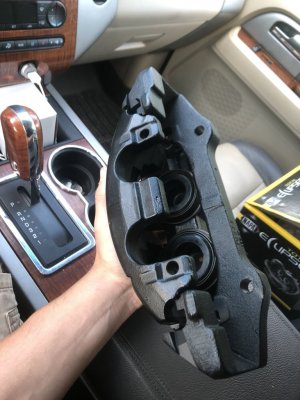

Hi all.
Just wanted your input into good brands of replacement calipers.
Heard some brands are junk ... Others are okay. And on rockauto centric says it can be used on the left or right which I find weird. cardone has a 10year warranty on one of theirs. I generally buy from rock or advanced but open to anything. if mail-order I probably try to do one without a core charge. I could even just do the rebuild kit with a new piston and seals with centric parts. Right now I have powerstop drilled and slotted rotors and akebono performance brake pads up front and original oem calipers.
I got a stuck caliper and have not dug in yet. It could be the caliper, slide bolts, or a collapsed hose.
Thanks!!
