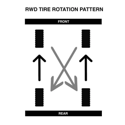

Well, I've always used this pattern for my rotations, as my dad told me about way back when I was a tweener getting my 1st car....granted that was a LONG, LONG time ago and all cars were RWD back them, but just sayin :D
But with the advent of FWD cars, has this been revised to the opposite or some other way ?

By the way, that tire rotation diagram came out in the fifties.
