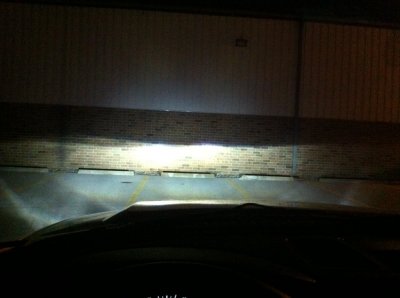

I installed my 55w HIDs in the factory halogen projectors and the light is perfect. I highly recommend that for anybody with factory projector lights.
This is about 25' away from the side of a building. I was trying to find a building that didn't have a reflective surface. I am pleased with the beam pattern and with the cutoff.

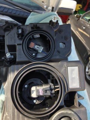

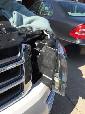

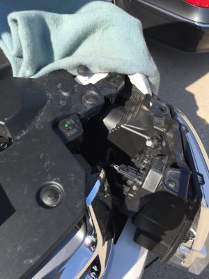

Two 10mm screws hold each headlight assembly in place along with a couple of spring clips that fit into holes in the radiator support. you just unscrew the two screws and wiggle the assembly out. You disconnect two plugs and the whole thing comes out. In this picture you can see one of the lower pins the other one is a spring clip.
The large opening is for the low beam bulb the smaller one is for the high beam. I had to cut a 1" diameter hole in the low beam rubber dust cover to accept the rubber grommet for the wiring harness that comes with the kit. I cut out that grey-ish rectangle with my dremel to make room for some other connectors that had to pass into the the housing and then I sealed the opening with high quality electrical tape and layered it like shingles to shed water. Unfortunately I didn't take any pictures and its snowing right now.
