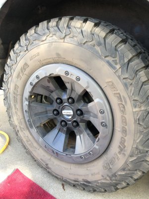

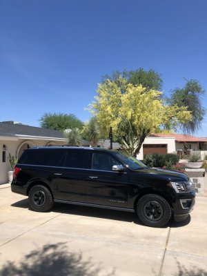

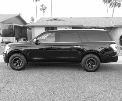

newer 17 inch ford wheels appear to fit any 4th gen expedition regardless of ccd or what yours came with. the one caveat is you will need to trim approximately 3/8 inch off the rear half shaft to install the pretty center caps on the rears.

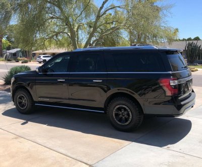

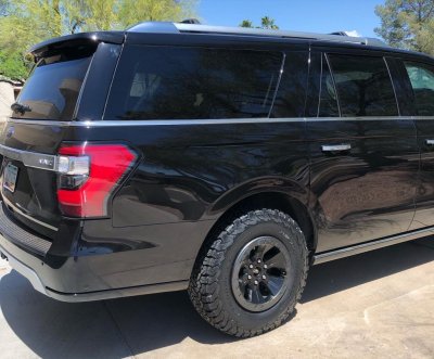

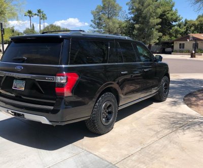

a 285/70/17 tire will fit and is approximately 2 percent larger than stock. it equates to 635rev/mile vs 647rev/mile with the stock 285/45/22.

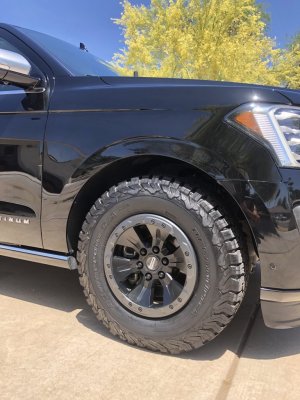

a 285/75/17 will fit but will rub under full stuff at lock. the felt liner will probably not take much rubbing before failure. i opted for the 285/70/17 and they fit the wheel well nicely (as they should i suppose since they are essentially the stock size)
