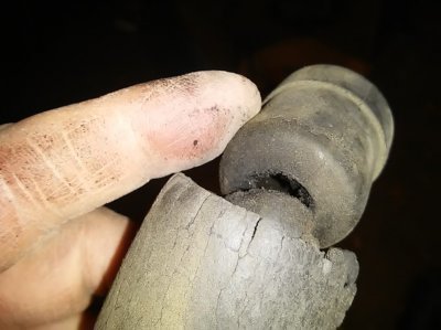

But I replaced the PCV hose after seeing the p0171 p0174 code. I started with just the valve replacement, no go. Then ordered a new hose, didn't realize it came with a new valve also. So here is a pic of the hose that caused the codes above. This part of the hose that's cracked is where it connects in the rear (near the firewall). Took like two minutes to snake through and hook up.

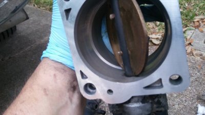

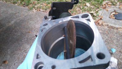

Well took too long but cleaned the downstream port of the throttle body (actually both ends). Wish I took a before picture, but here are after pics of it.

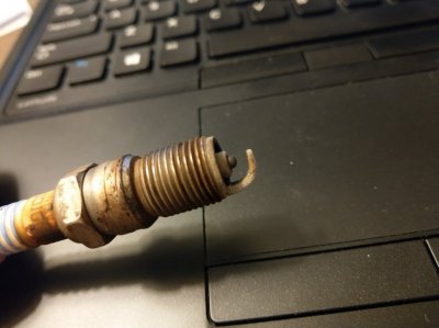

I might have found the solution after many months.
I decided to do a little refresh so changed the plugs and all coils. I had three coils go out in the last year which I believe can be caused by excessive gap. Also did a MAF cleaning. Holy gap batman!
I think the culprit on the hesitation was plugs. Here is a sample of one.IMAG0104.jpg

I had the same issue coils are a common issue and some good spark plugs look like the original ones...
Holy cow. You think these plugs are from 2001?? They were never changed??
