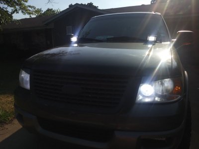

I'm installing some rear lights on Bonnie and finally connecting the hood lights.20190718_212708.jpg

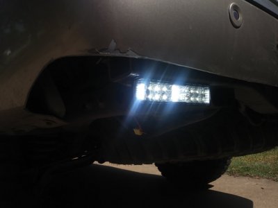

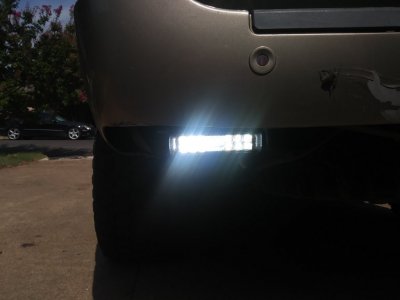

Trimmed about 2.25 inches off the bottom of the rear bumper in order to allow a good line of sight for the rear lights to be more effective.

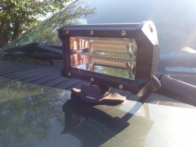

Let's see the hood lights and mounts!

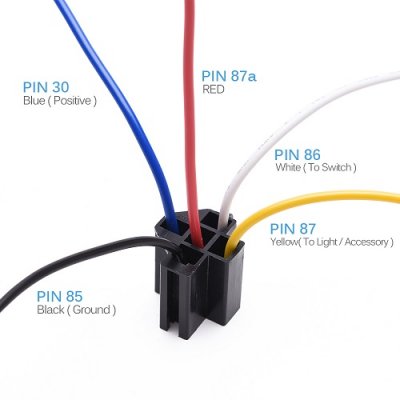

I opted for clamp mounts so as to not drill holes in my hood. All lighting goes through waterproof relays.
