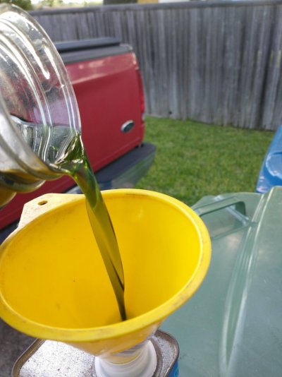

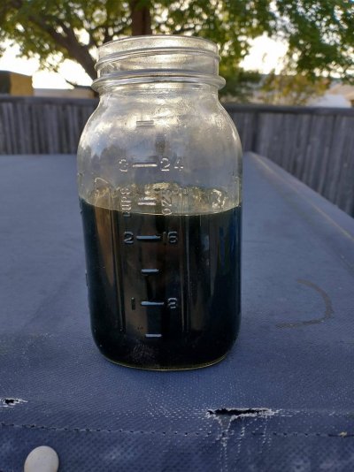

lonestarjeff
lonestarjeff
Feb 1, 2019
94
49
The Colony, TX
I had a couple of unopened quarts of DOT4 left on the shelf, so I put the pressure pot to use & flushed mine. The old fluid was dark green & had a few lumps in it. I did have to find the adapter cap for my master cylinder. Here's a couple of pics of the old fluid....
