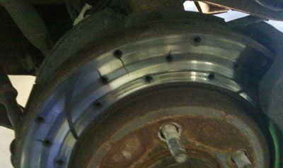

Don't buy the cheap drilled rotors they crack very easy since they are just junk rotors with holes drilled in them no backing support for the now weakened spots. Also make sure to do a fin count on the discs you are buying, if they have fewer than stock ditch them quick they are again junk rotors.

For those who believe cheap cross drilled rotors hold up do some research and come back.....A quality cross drilled rotor will have a completely different look and feel than the cheap ones. You think the cross drilled on MB BMW Audi are the same quality as the chinese crap from napa, amazon or ebay?
Dangerous cross drilled rotors - EBC Brakes
