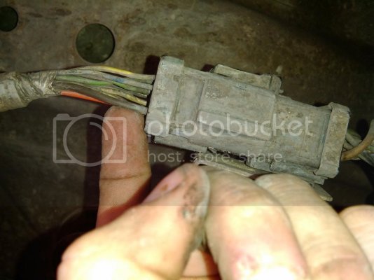

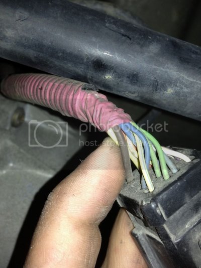

Finding the wire in the truck was the hard part, but here is the wire in question looking under the truck. This is it on the motor side of the connector:
And this is the same wire on the truck side of the connector:

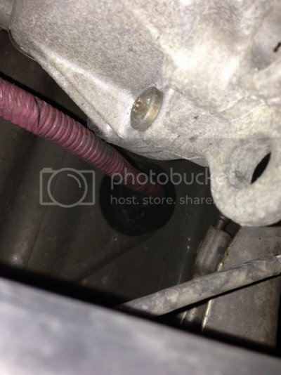

Here's where it enters into the body:

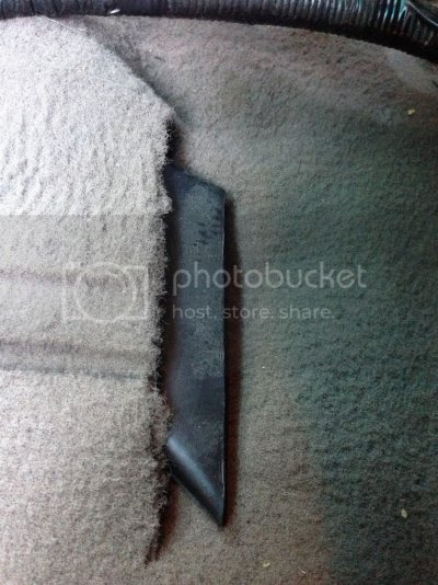

I did have to lift the drivers seat out of the way because the harness enters the body directly underneath it and it is accessible through the hole in the carpet where the rear floor heater duct pokes through as seen here:
So, now is the time you get to cut. Cut the wire and splice your new wiring for the switch in line with the brown wire in the above picture. I used make and female spade connectors just in case I ever wanted to revert back to stock, but you could certainly use butt connectors and be fine. Here's a pic with the wire spliced in:

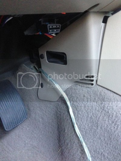

So now run your wire under the carpet toward the front of the truck. I ran mine in the channel where the console meets the floor so I wouldn't have a lump under the carpet. It should come out here:
Make sure to tuck the carpet back underneath the heater duct for optimal rear seat passenger comfort:

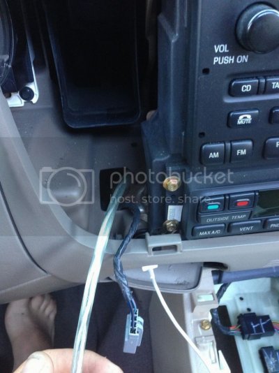

Now remove the stereo bezel that houses the 4wd rotary switch.
Then run the wire up through the dash (I used a stick poked through the hole the 4wd switch wires come through, and ran straight down to where the wire was in the above picture, then taped the wire to the stick and pulled it through) and zip tie it in place so it doesn't fall back through when you put the bezel back into place:
Lastly, find a place you want your switch (I wouldn't suggest to mount it where I did because I had to snip off the lower mount for the vent above the switch due to the retaining nut for my toggle was too big and needed room. Thank goodness ford put the two tabs on the side or it would be flopping all over in there!) and wire it up. I used a switch with an indicator so I needed a ground, I found one in the climate control harness pictures below, but any ground will work.
