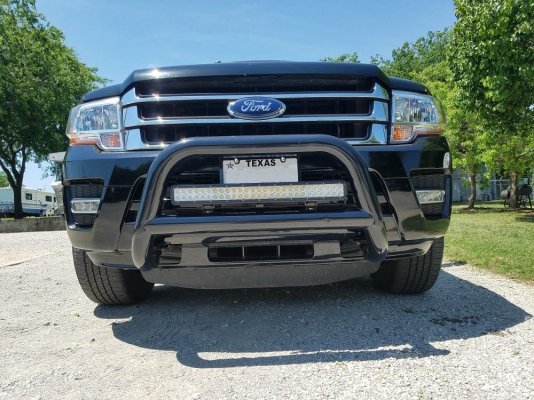

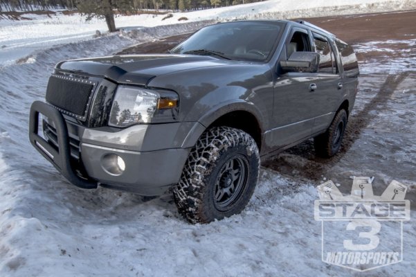

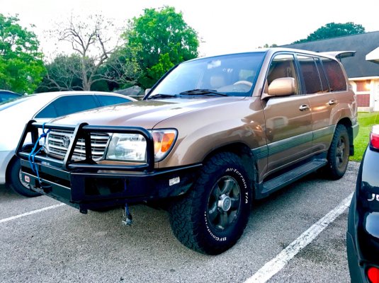

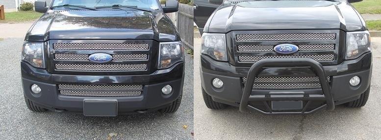

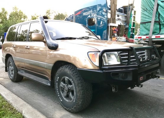

Hunter:
https://www.hunter4x4.com/bull.html
Lund F150 easily retrofitted:
Aries B35-3007-3 Stealth Bull Bar with the skidplate removed:
Vaccar prototype Grill Guardian:
The population multipliers have been calling these damage multipliers forever. Its like listening to a vegan explain their diet. Just a little disappointed nobody called out your approach and departure angles getting decreased, reduced MPG. You know, important stuff, up there with how much damage you can avoid while hitting something at 50 MPH.
Since they all mostly mount to the tow hook provisions on the frame rails, F150 bars should work.
The only valid concern I've heard to date is interference with your front parking sensors, if equipped.
