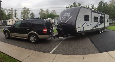

PrepVet - I have a 2015 Apex 300BHS Ultra Lite. (http://www.coachmenrv.com/product-details.aspx?LineID=62) About 6000lbs. dry. GVWR of 7600lbs. These new composite trailers are the way to go - never even looked at the old tin ones. Not as fancy as something like an Imagine but also about 1500 lbs lighter and $15K less expensive. Just upgrade the master BR mattress to a memory foam.
Just got back an hour ago from a 350 mile round trip with the grandkids visiting the Wisconsin Dells indoor water parks. We had 15-20 mph winds on the way back to IL today out of the north, which meant hitting me on the left at least half the way back. Except for a few times where we would be about 100 feet behind a semi and his draft was swirling around, the Expedition has absolutely no issue getting this thing up to speed and keeping it at 65 mph. I do use an Equalizer WD hitch setup which works great and seems to help in the wind. Heavy duty trailer package of course. Had to get the clamp on trailer mirrors but they do the job. Good luck with your search!
