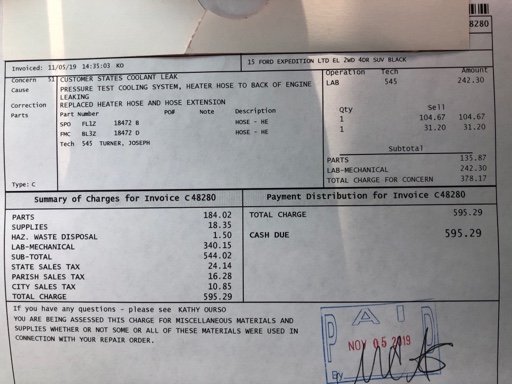

Having similar problem with occasional coolant leak on 2015 EXP.. Dealership has changed several hoses. Not sure that fix problem until drive for a while.They are working of a strange sound now that may be a air leak around the turbo. Driving loaner now. It has been in the shop a better part of a month now.
