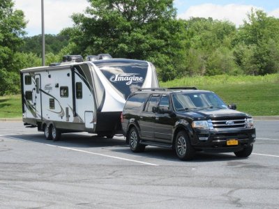

I tow a 31 feet overall travel trailer with a ready to camp weight of 6500lbs. Our 17 Max ( EL) tow it better than the 2016 F150 I traded in.
I Haven't use the DOT scale yet but Im pretty sure I'm near the limit of the rear axle.
I wouldn't tow a 9000lbs trailer with it...
