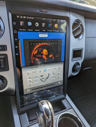

For anyone who stumbles on this old thread while searching around -- I swapped a large touchscreen from KSPIV (seems to be the same manufacturer as Phoenix mentioned above) into my 2015 about a month ago and it looks like it goes there. Climate control works a it should, OOTB. I'm tracking getting everything dialed in the way I want in a little GitHub repo here: https://github.com/cilynx/expedition/tree/main/Infotainment
