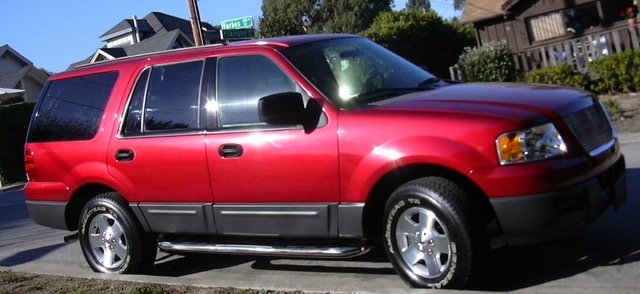

My 2004 seats 9 (bench front seat). Limited storage space with 3rd row used for seating.
