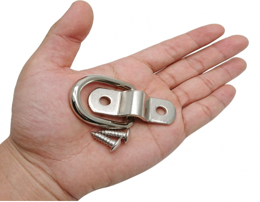

Hi guys - I am looking to provide a tie down mechanism for a bag big enough to hold a tow strap, jumper cables, etc. I have several possibilities for the bag, but I note there are zero tie downs back there. Any experience with how to add some tie downs? I’m just not sure how to proceed with drilling into something import!
Crawl under the vehicle and look and measure what may be in the area you want to locate the clips. You can size your bolts or screws to limit interfering with anything that may be underneath.
