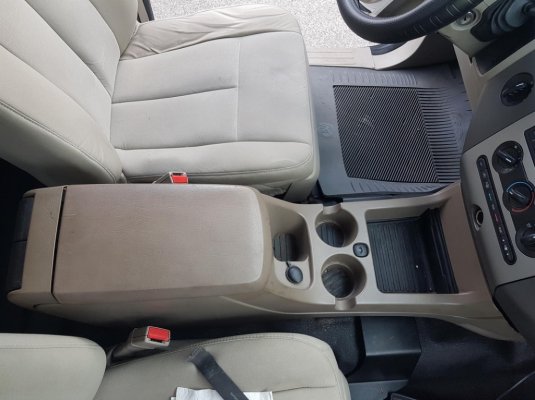

Here are some final pics. Note that I installed it before cleaning it... the console came from the scrap yard all dirty and sticky, whoever had it before never cleaned the interior of their truck, lol. I cleaned it once the installation was finalized, after these pictures were taken :
All clearances perfect... almost like it was made for the SSV!
Now I've got me fake rear climate controls, lol!
...and rear cup holders!!!!
Last thing I need to do is to wire the 2 extra cigarette lighter sockets in the console to the one in the dash. Extra sockets are always welcome! (this console has one in the front and one in the back)
All in all, I am very happy with the result. The console is sturdy and very functional, plus I like the fact that it's not as thick as the stock Expedition / F150 console, as there's more space between the seat and center console.
