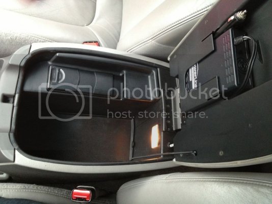

I always hated that I cant see whats inside our console box at night and I dont like illuminating the whole cabin especially while driving
had extra time on the weekend, and this is what I did
I tapped into the 12V rear socket so its always hot. I also installed a door trigger that can be switched off temporarily if in case I need to leave the lid open, I can off the light.

That is cool...thanks for the idea

glad you liked it.
the lamp and the trigger switch is from the glove box of a Mercedes 190E
