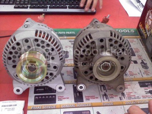

you should be good to go. also i think all bolts are 10mm but i could be wrong. ford seems to like 10mm for its bolts. you need pics lemme know.
old vs new.
old vs new.
