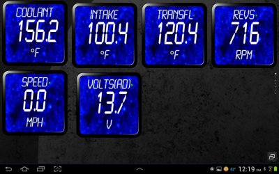

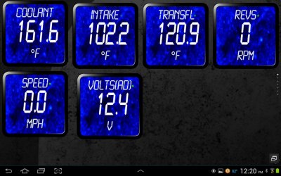

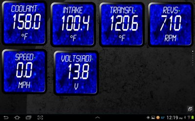

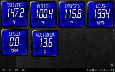

dadamaja
three things to check
1st check the battery voltage with engine off and all doors closed and all lights off. post voltage
2nd check battery voltage with the engine running at idle and post voltage and RPM's
3rd run engine approx. 1500 to 2000 rpm and check battery voltage post results
Bedrck47
Jul 4, 2014
5,641
652
Elizebethtown, PA
Based upon your description of your problem I would not assume your alternator is bad
without doing proper troubleshooting FIRST.
You state the there is a fair amount of corrosion on the posts, Clean the post and cable connectors with some baking soda and water then use a small wire brush to clean them.
Next check the battery voltage as I suggested above
Get back to the forum after you done the above.
If indeed you need a alternator now is a good time to check prices out and possibly order a replacement or repair parts
