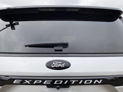

    Saturday morning at the shop for a complete chrome delete wrap. Stay tuned

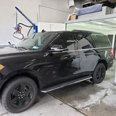

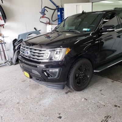

    Finished!! 6 hours later!

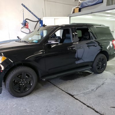

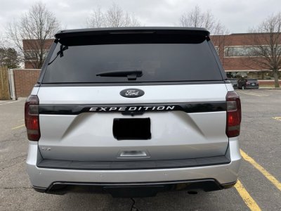

    Back

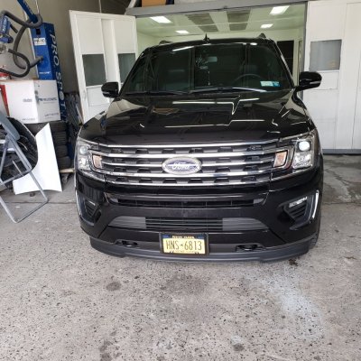

    Front and side

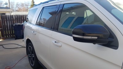

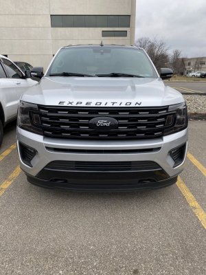

    Ha, I did mine today as well! We'll see how long it lasts, I've never wrapped anything before. Wasn't too bad, except under the side mirrors. Unfortunately I had washed the trim area last night (didn't wash the whole vehicle which was dumb, just didn't have time) and dried it. Well there I am tucking vinyl in under the trim piece and the squeegee comes out wet! So I did my best to dry, but not sure if the adhesive on the vinyl will hold as well.
