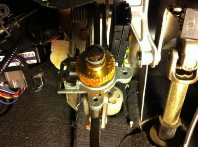

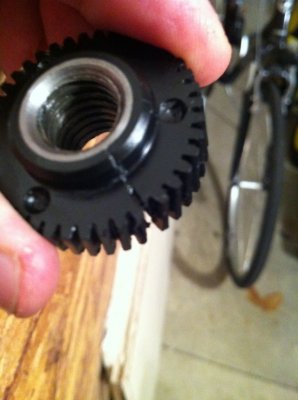

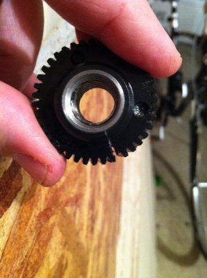

Wondering the same thing... is it the same gear for both the gas pedal and the brake pedal? I found the gas pedal gear is split and the worm gear was trying to ride up the teeth on the driven gear. I don’t know how long it’s going to work, but I filed the teeth on the both sides of the break and now the pedals are working just fine.
Yes the same gear controls both sides. They move together.
This what my old gear looked like.
This was after I installed the replacement gear I got from Curless Auto.
