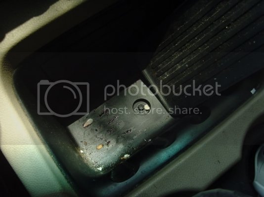

Here is the screw you have to remove in order to have access to the front center console (sorry about the dirtiness, spilled something):
It's under the rubber "mat." It's either a 10 or 7, can't remember. From there, you can see the wires going to the 12V power point and cig lighter.
