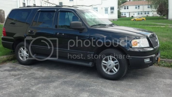

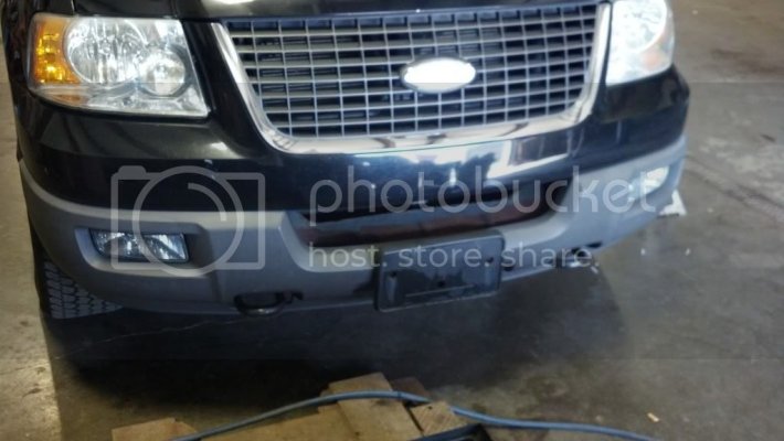

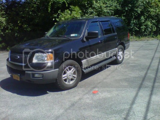

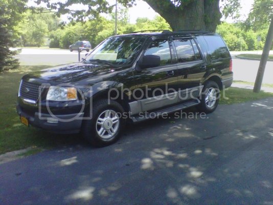

Ok guys so this is what the truck looked like after I got her home and started cleaning up a bit.
It was a big improvement compaired to when I got it. My next project was to clean up the outside a little bit more.

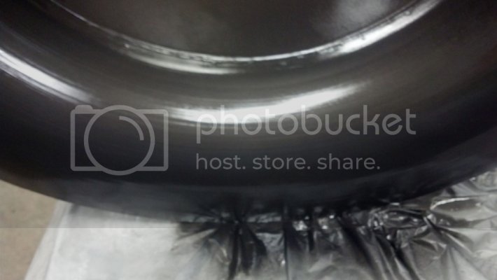

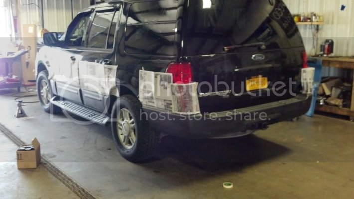

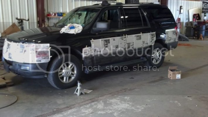

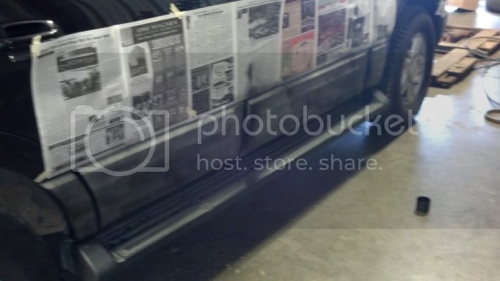

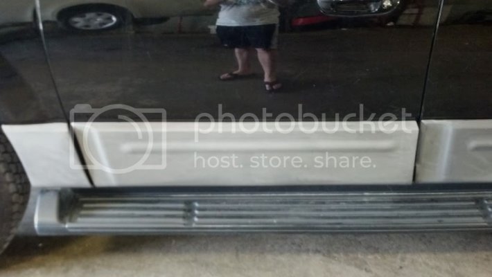

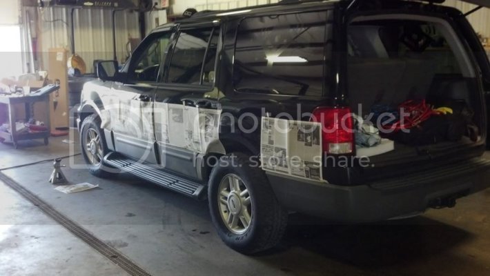

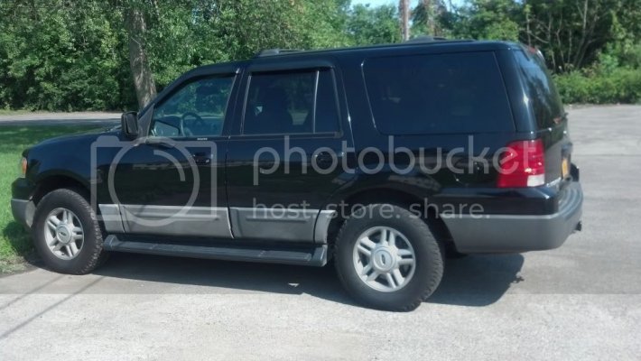

Ok guys, so we all know about the fading of our plastic cladding. It makes me truck look so ratty and I hated it, (one of the reasons I joined the forum). I decided to go a different route then most guys on here using the krylon fusion paint. I decided to go with black plasti-dip and I could not be more pleased. All I did was give it a good cleaning and made sure there was no dirt before i started to plasti dip
Here are a few pics of me doing the plasti-dip:
what I started with.
mine were so faded it may have just been white haha
here is where I went wrong. Please guys if you try this leave a good 3 inches of gap between your cladding and the metal of the door itself. It will come out much better when you pull the extra off and will give your a much cleaner line.
Here comes the first coat (I did four of them I believe)
This is still wet after the 4th coat has been applied.
after it was fully dry (was a humid day)

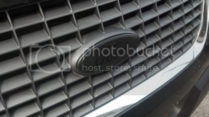

After I finished up on my door claddings I decided to try it on my blue ford ovals (once you plasti dip something you want to plasti dip the world....... its addictive haha!
What I did here was mask off a square around the oval and did about 5 coats. After i let it dry for the day i cut myself the ford logo in gloss black vinyl to go over the plasti-dip. It was something I thought would look neat and turned out it does. I love doing things I have never seen before. heres the finished product, I did both front and back ovals.

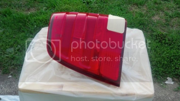

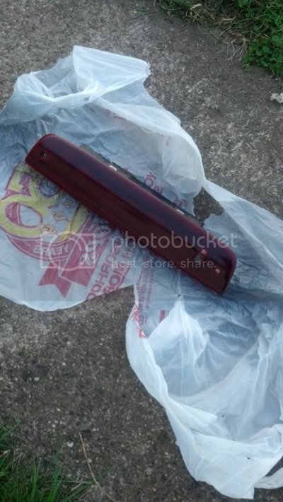

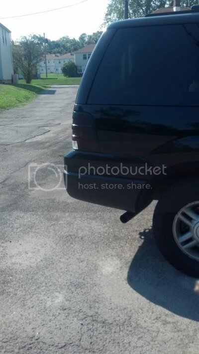

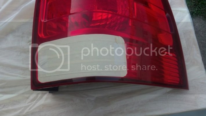

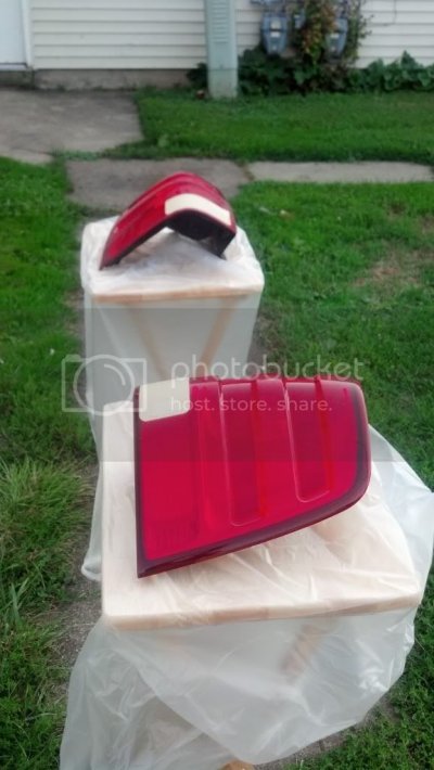

Ok, well now since I went with the whole "blacked out" theme I tinted my tail lights with vht nightshades.
Also a little tip to not do what I did, use duplicolor clear coat, I used a cheap-o 99 cent can and it hazed badly, I got all of it out with rubbing compound and am yet to buff them out to a mirror finish yet but will be doing it in the near future. So dont cheap out like I did and it will save you the headache.
Here is where I started out, I cleaned them with soap and water, then scuffed them with 1500 grit to lay my first coat, you can really get a great finish with wet sanding between coats and buff them out and they look like mirrors if you do so.
After that I masked off my reverse lights because I didnt want my whole light black and to give a little contrast to the truck still.
(an easy way to mask the lights off is make a square with the tape then put a flash light where your reverse light plugs into to see the outline and cut the extra tape with an exacto knife)
First coat of vht on

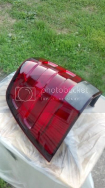

2nd coat of vht
after 3rd coat with my clear hazing everything up
Installed on the truck (not buffed) This was with 3 coats of vht nightshades on it in direct sun light.

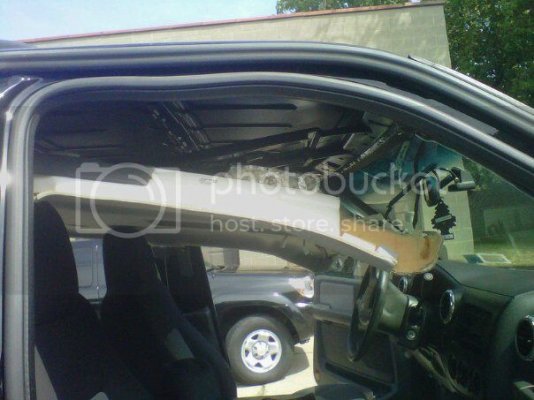

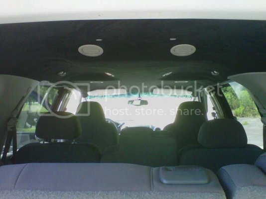

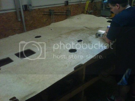

After being pleased with the outcomes to the outside of my truck, I began to rip out my nasty headliner, strip it, and wrap it in black suede.
While I had it out I also started to rip out the third and middle 2nd row seats to begin my stereo build. While everything was out I optied to not re-install my middle counsel on the headliner as I feel it will break and fall out after my build was done.
Out comes the headliner
The headliner is out!
Me and a buddy stripping the foam adhesive getting it ready for me to reupholster it

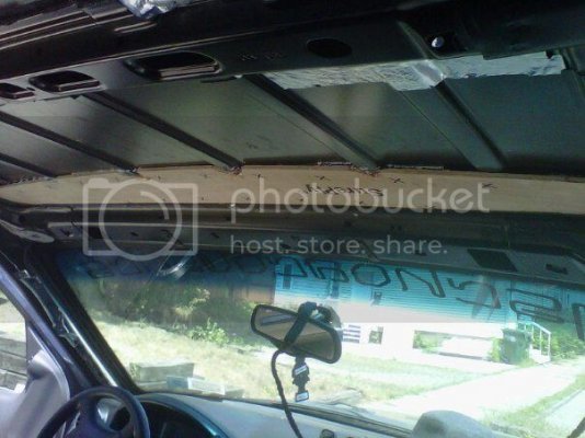

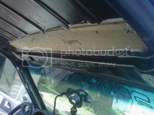

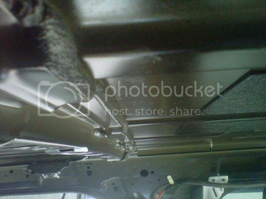

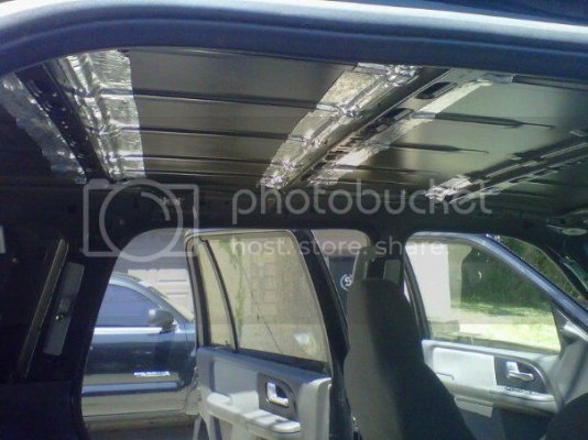

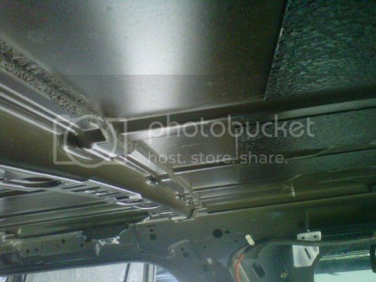

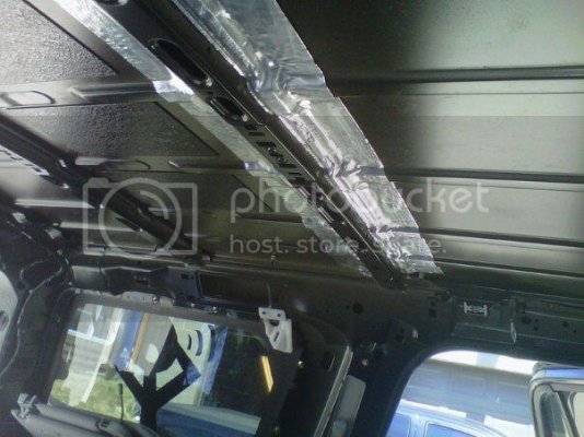

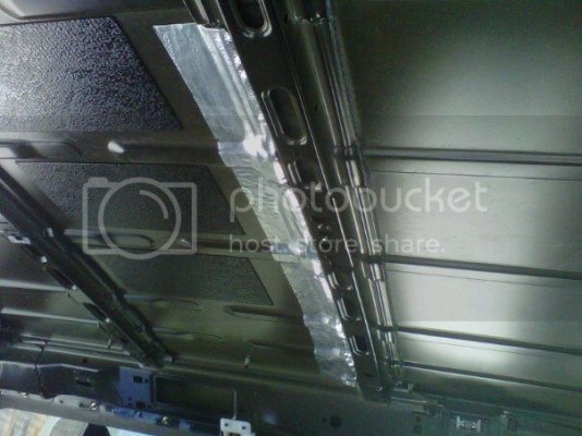

Now while I had it out I needed to do some bracing, I braced the roof with sound deadner as well as wood. I did not take a lot of pics during this process but what I did was take a razor blade and cut the access deadner foam inside each roof brace from the factory and make them flush. After I did that I cut strips of sound deadner and wrapped each metal roof brace, added wood bracing throughout the roof and then covered everything once more with a layer of deadner.
here is the factory foam before i cut it to make it flush
This is after I cut the foam flush with every brace.
here is the strips to go over each brace
front bracing

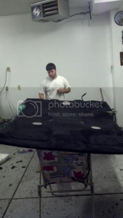

Now that I had everything braced (again sorry I didnt take any finished pictures of it) I wrapped the cleaned headliner in black suede.
It turned out very well although this was the tuffest headliner I have ever done because it is not symmetrical and very wide and long.
This is me making some final tuck and cuts and installing all the lights/ and air vents.
Here is the finished product!

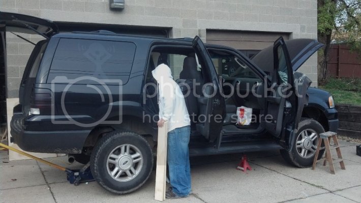

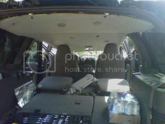

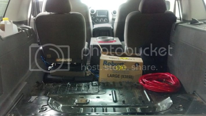

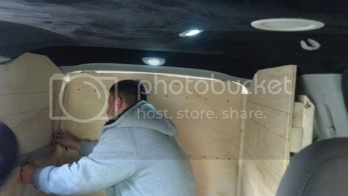

Ok so now that I have the truck looking pretty slick if I dont say myself, it was time to start my build. I again pulled out all of the third row and middle 2nd row seating, carpet, jack, and other panels to see what I can work with here.
I also installed my double din as well, I went with an Apline INA W900bt. It is amazing, Very clear picture, gps, very fast with your ipod, blue tooth, and everything ya can ask for :)

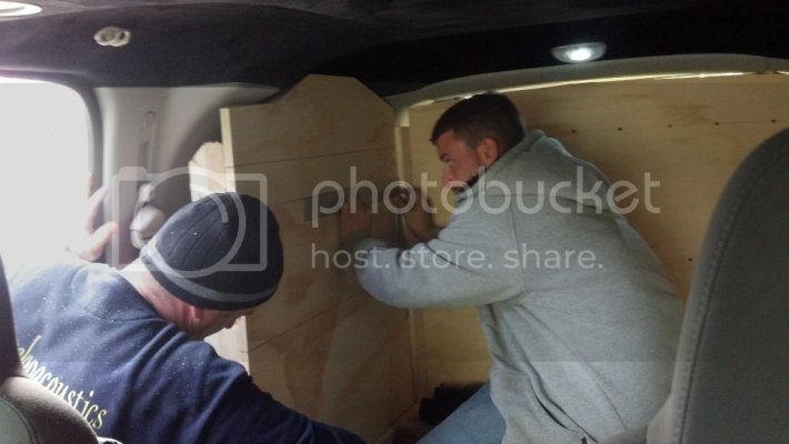

Ok guys now here comes the fun stuff. I have stripped the back of my truck to build my wall. Again I may be speaking a different language to some, and many will not know the gear I am using but Im sure some of you do. My equiptment consists of some of the following:
Headunit: Alpine INA-W900bt
Subwoofers: T3 Audio T2000 15s Dual 1ohm voice coils
Sub Amp: American Bass VFL-1100.1
Mids and Highs amp: American Bass VFL-350.4
mids: sealed backing 6.5" mid range woofers
Highs: TBD
Wiring: 6 runs of American Bass OFC 0gauge wiring
Batteries: Northstar energy one sealed gell batteries.

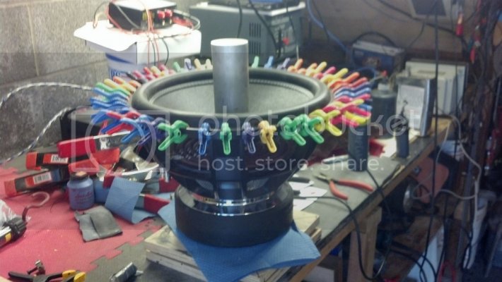

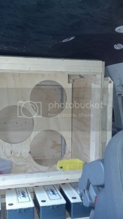

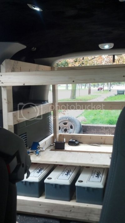

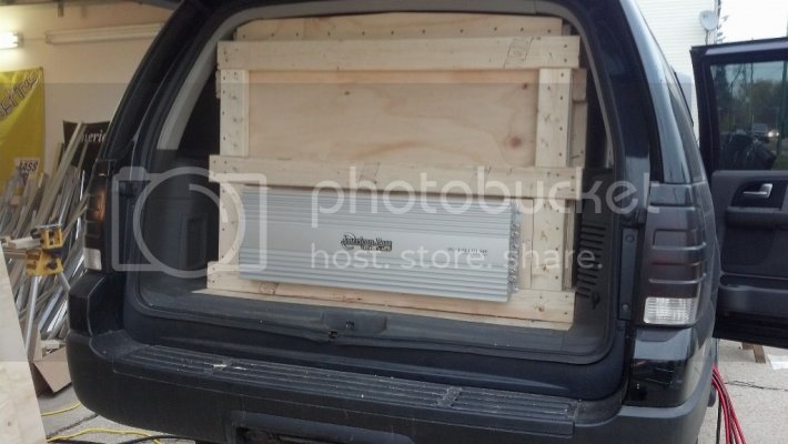

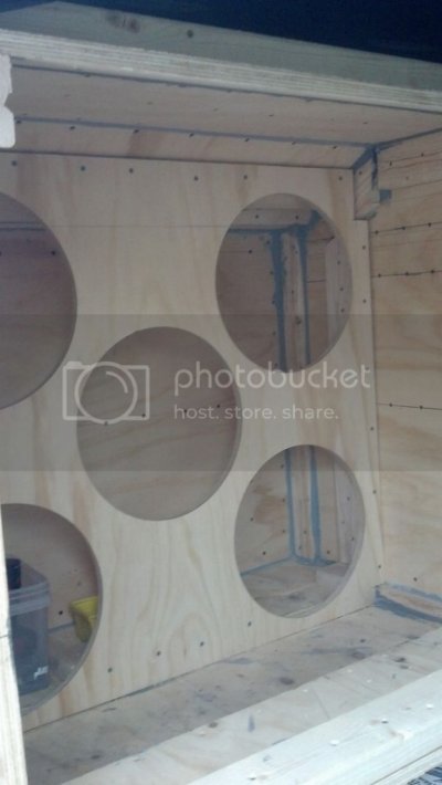

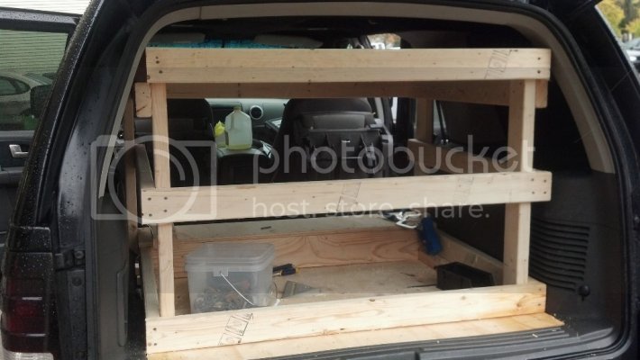

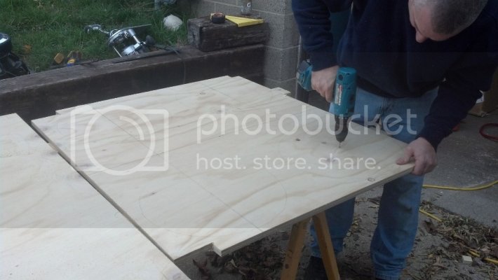

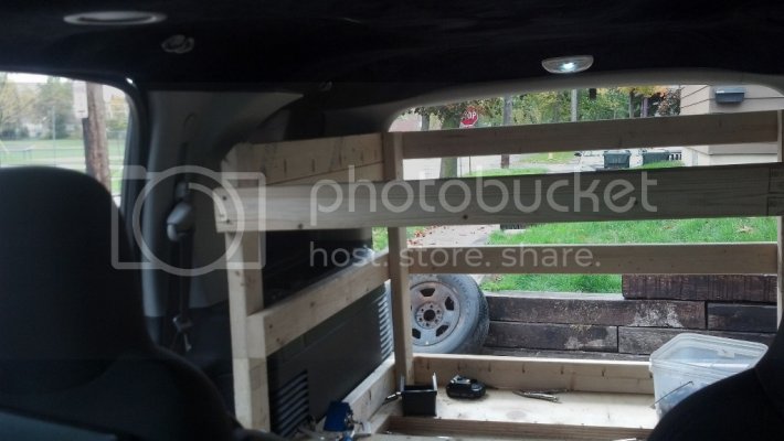

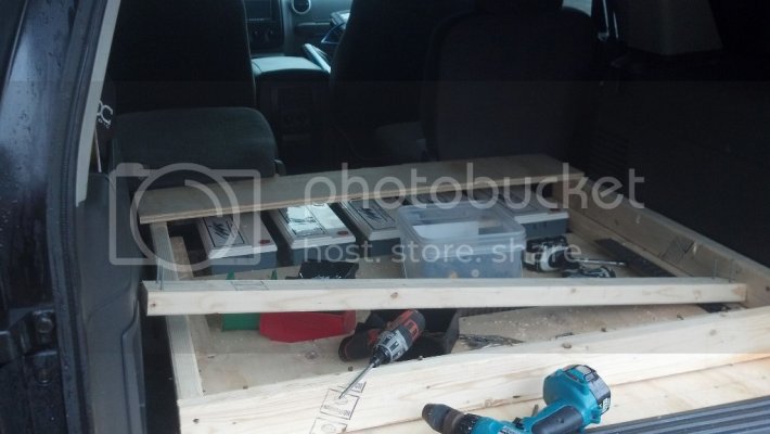

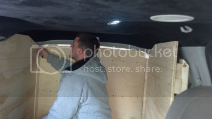

Here is one of the 5 15" subwoofers that will be used in my build
No before I built the wall I wrapped the inside of my windows with black vinyl so you can not see in aka 0% tints haha

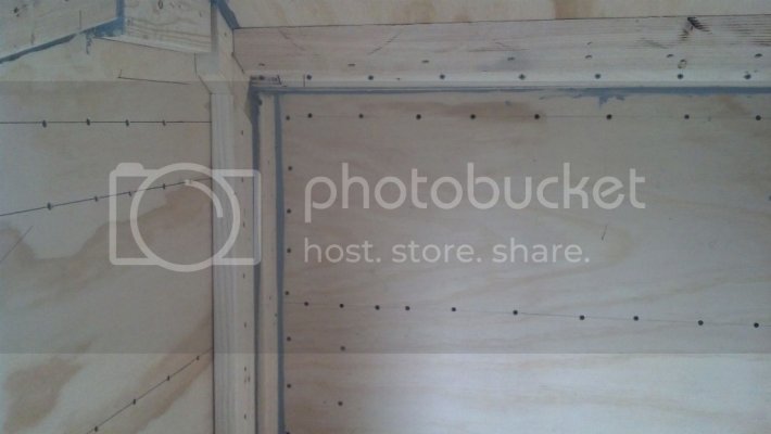

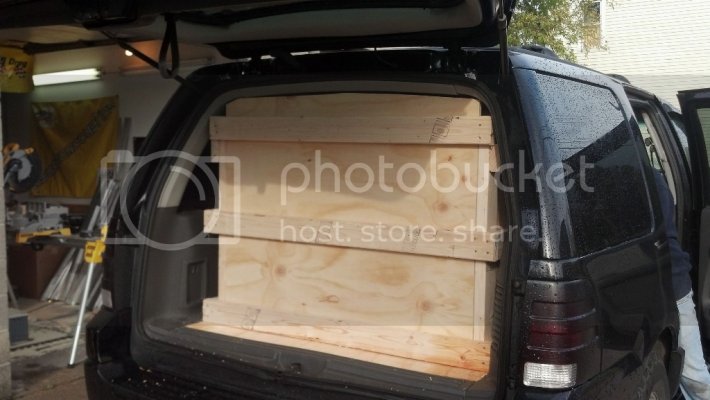

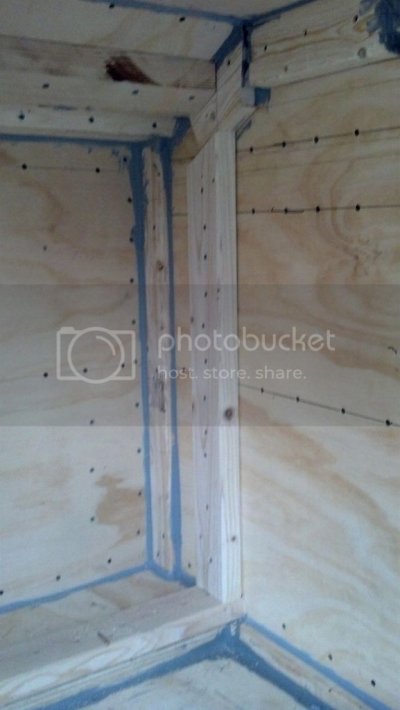

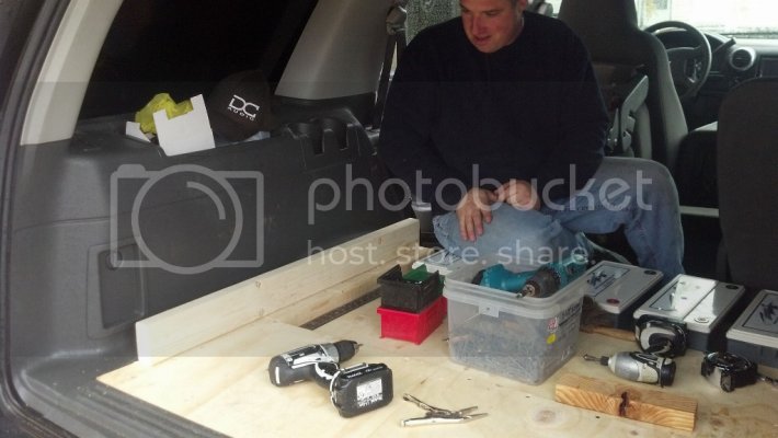

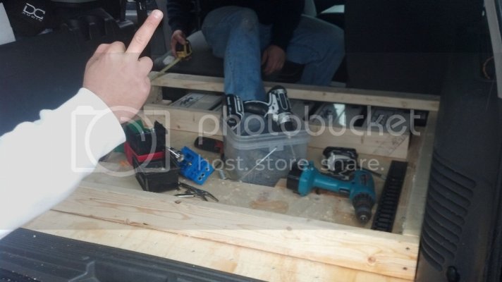

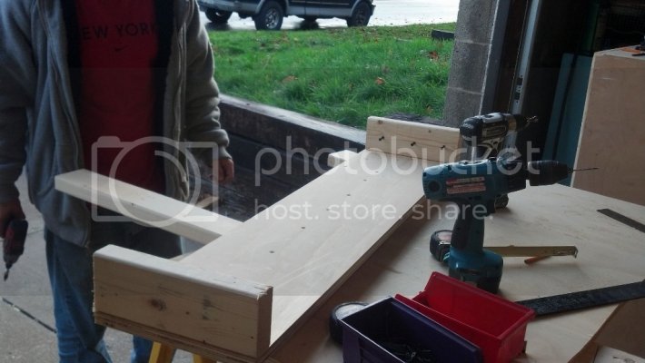

Now I have built this inside of the truck, it is bolted and braced throughout.

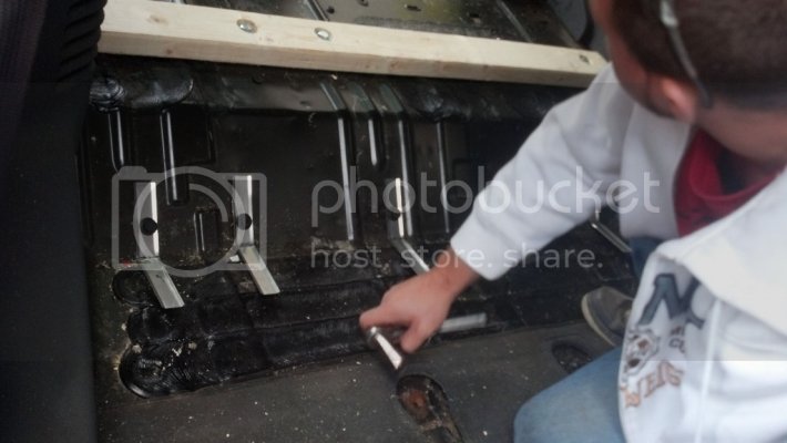

I am starting the floor and brackets for my battery bank
The battery bank:
Building up the dips in the floor

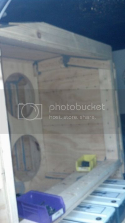

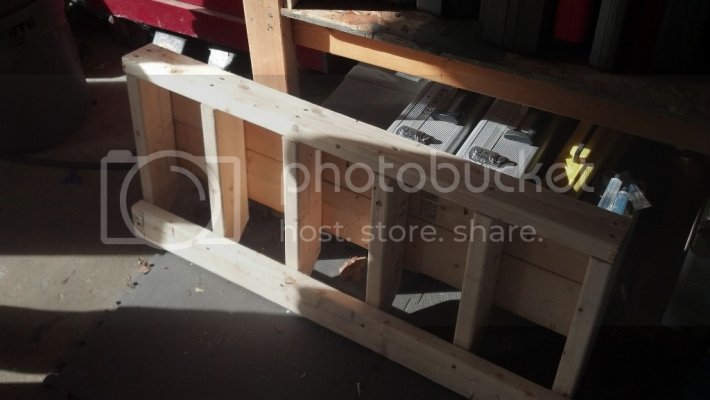

The start of the skeleton of the wall

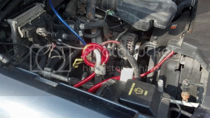

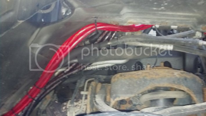

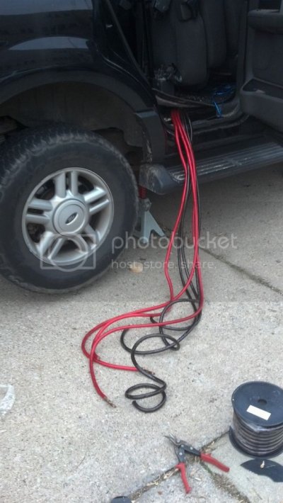

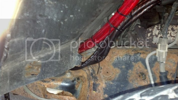

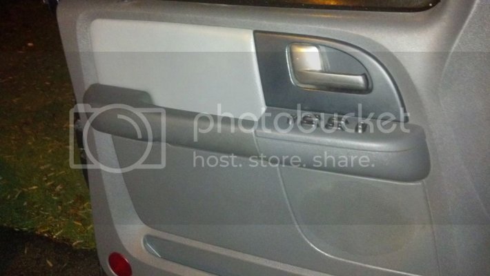

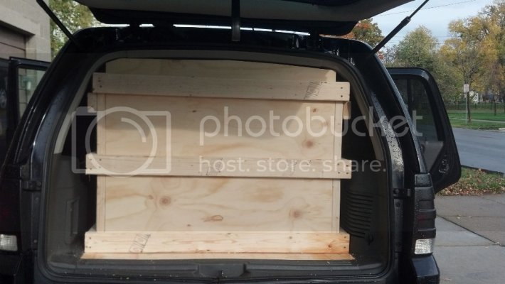

Ok guys this is where I am at. currently. I have finished all my buss bars, have done the big three upgrade (h.o 300amp alt) coming soon. All my wiring is done. Now I am at the point where I am working on my doors before I install my port and front baffle and wrap that in black suede as well.
here are the doors and here is a basic sketch of what they will look like when they are done.

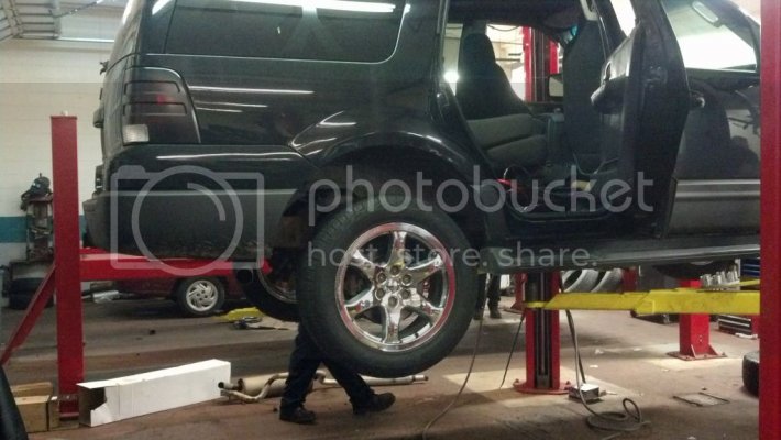

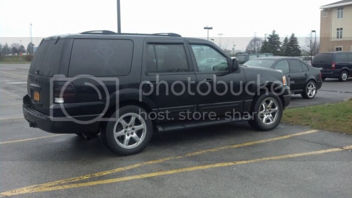

Well in the mean time during my build I bought a set of 20" roush rims that are off the roush f-150 ...... the truck looks super mean with them on, here are a few pics of them. I also have a set of halo headlights that should be here this week.

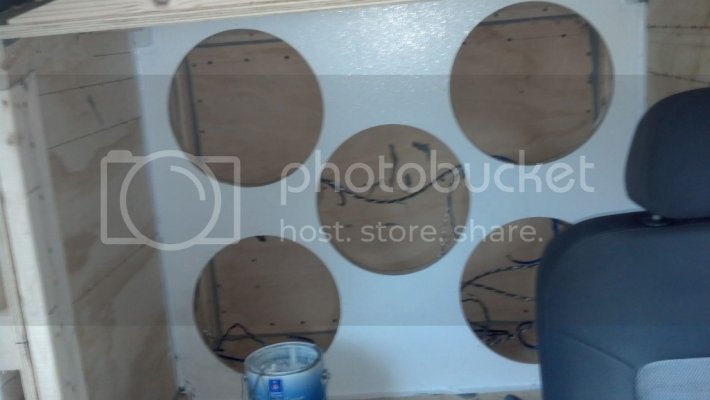

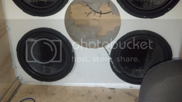

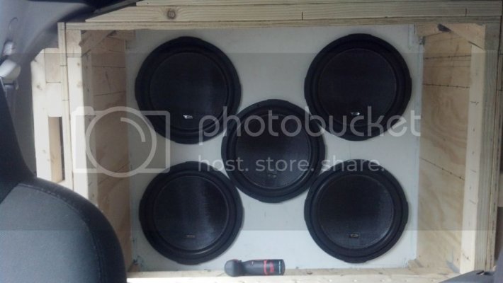

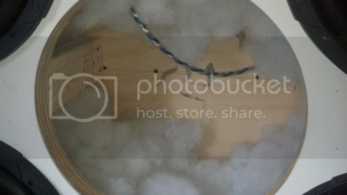

here is all 5 of my 15s wired up at .4ohm
front baffle, port, and beauty panels done in suede soon to come.
