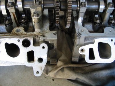

Please forgive me if this topic has been addressed before, and if someone could point me in the right direction i'd greatly appreciate it.
I have a 98 Expedition with a 4.6 and I'm looking into upgrades for power and fuel economy. I've heard rumors and inklings of a different cylinder head for my truck that's referred to as "Performance Improved". As I understand it those heads can be gotten off of some Crown Vics with the interceptor motor and possibly even some of the new mustangs with a 4.6 as well. Can anyone verify this for me or at least point me in the right direction.
Again, I'm sorry if this has been answered before and greatly appreciate any help or info given.

The PI heads came with larger intake and cams.
In 2002 the PI heads were placed on the expedition with the 5.4. I believe the 4.6 received the PI heads sooner.

I have been out of the older mustang crowd for a while. So I'm not sure if the mustang heads will have all the accessories on the heads you need.
I have heard the crownvic will bolt on.

Yes, performance improved heads will increase your torque and horsepower by increasing compression ratio. Have the ports polished first before putting it in.

It will be alot of work for 20hp or so.....consider a 5.4 swap with trick flow heads if you have cash.
