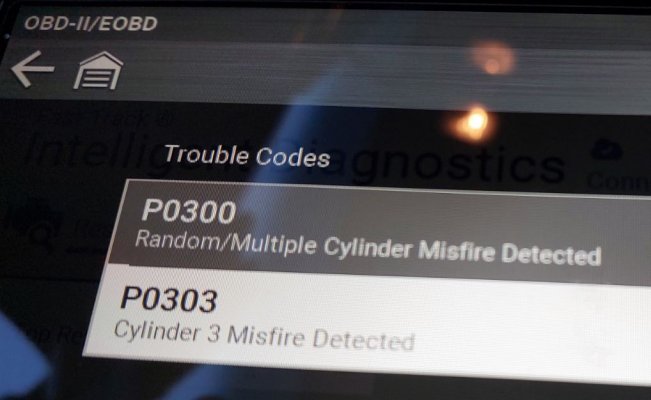

Hi again from the UK! My check engine light came on a few week ago and we got a misfire on cylinder 3 (PO303) so I got some spark plugs sent over from the US and after a week it came back on again. So I got some coils sent over and replaced all them, but same problem. The car is in my local garage today for another thing but the guy is gonna see if he can work out what's going on. We don't have Expeditions here (apart from mine and few others) so any tips are welcome. I have looked at the other posts on similar subjects and we will see if the injector looks ok, maybe swap it with another one to see if the fault moves cylinders but the garage owner has never seen an Expedition before, hence the question.
Also - the PO300 warning may suggest something else? Not sure!

OK bit of an update. The check engine light seems to point at misfiring on Cyclinder 3. All the spark plugs were replaced in Feb 2024, the coils were replaced. Same problem. The injectors were cleaned, same problem. The plugs, injectors and coils were all swapped with Cyl 1 but the problem stayed on Cyl 3. The pressure on Cyl 3 is just 10psi lower than the others and well above 100 so that should not be a problem.
Still getting the problem and not sure what to try next.
Any suggestions welcome.
