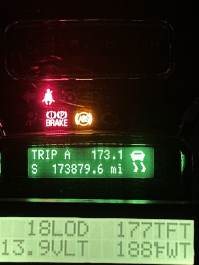

My 2011 Expedition XLT EL shows the lights inthe picture (ignore the tire light) and the ABS, Stability and Parking Brake come on when I get past 30mph. Nothing is affected performance wise. Anyone else had this problem and find a solution? 5DCD5787-ECDE-40B4-B025-6CF343CBE87B.JPG

What kind of ABS codes are you getting ? Do you have a code reader ( or ForScan...) that will read ABS codes ?

When you get all those together it usually indicates a wheel speed sensor. Diag will tell you which one (or if it is something else)

I had similar lights pop up on one of my vehicles that ended up being a wheel bearing, which would affect the speed sensor.
