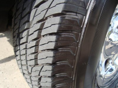

BakerEdition
EF Chaplain
Aug 6, 2011
2,115
61
I bought these all season Kellys and had them balanced and installed for $580.00 The have an aggressive tread pattern for snow and water, but are not noisy and ride really nice. My 2 cents...good bang for the buck!
