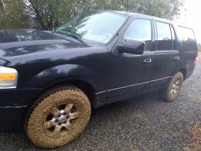

Experiencing the first rains since I purchased the truck, my (2010 "SSV" with 4WD) is having a hard time getting up my slippery dirt road in the rain. I recently almost got stuck in 4 Low.
I am running the stock tire size 265/70R17 Goodyear Wrangler All terrain Adventure (cop tires.)
My understanding is I should turn off the traction control when stuck, since it is applying the brakes, which makes it more difficult to get unstuck. I also believe both differentials (front and rear) are "open" and rely on the traction control / stability control system to prevent wheelspin in less drastic situations.
My primary questions are
1. Are both differentials in fact "open"?
2. If yes, is there a junkyard swap part (from pickup or other trim level Expedition) that has a limited slip differential?
3. I am looking at purchasing a TrueTrac limited slip unit (Torsen-like )for my truck's rear differential. Anybody have experience with this part?
FWIW, my diffs are 3.73:1 ratio.
Finally, my other truck has no prob getting up the road, but it has 37x12.5 inch tires with 4wd and Torsen differentials front and rear.

I'm far from an expert on 4WD … but my guess would be that the tires are the limiting factor here (assuming 4WD is functional without some major fail). Tires like that can fill up fast and become slicks. Can't they?
You can determine if you have LSD by looking at the axle code on the sticker plate on driver door threshold, and looking it up in Ford brochures. You might have that already?

IMO tires make a big difference on greasy mud or ice, particularly when you add grade. I'm assuming the road is smooth and all 4 tires are staying on the ground?
mschiap
mschiap
Mar 24, 2019
SoCal
It's a smooth dirt road, with a litte gravel on top. But a fairly steep uphill section. Rear tires with deeper tread are probably the easiest improvement.
