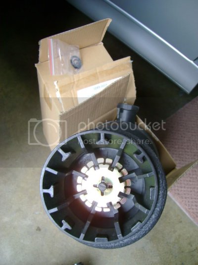

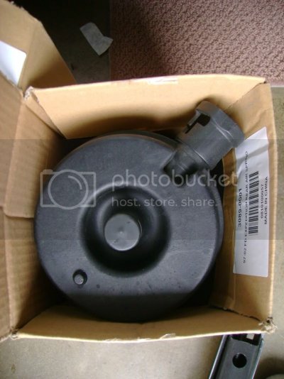

I was lucky to be able to source an aftermarket brand for $185 shipped (pair).
Heres what they look like

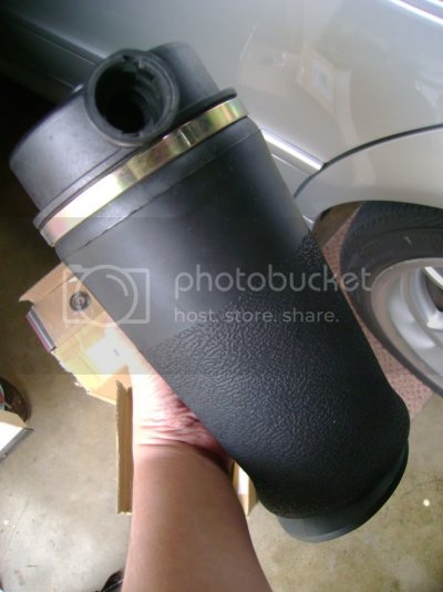

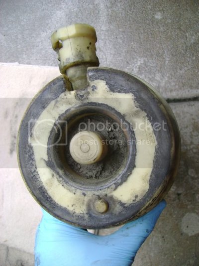

With the jack positioned under the chassis, I was able to pull the 1st air spring. Nothing to it, just pull the C-clip on the top with needle-nose pliers and remove the clip locking the air nozzle to the air spring and it falls off. the bottom part of the bag isnt even locked to the transaxle. its merely cupped

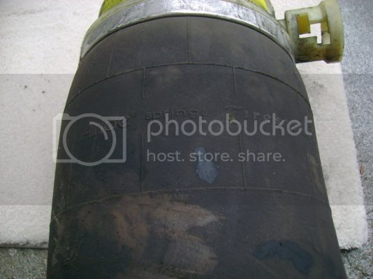

Pics of the old bag (made by firestone)

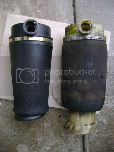

Here is what they look like side by side with the new

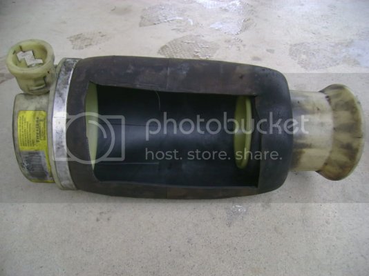

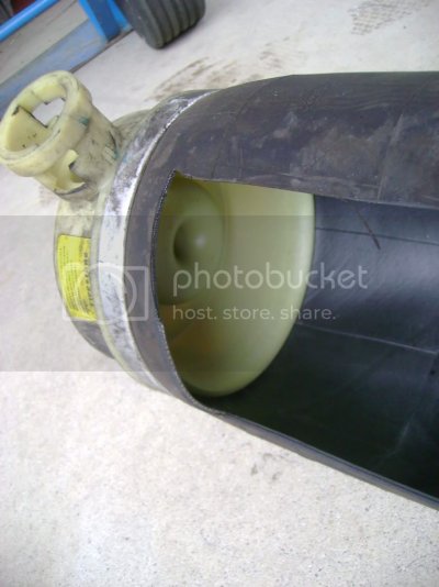

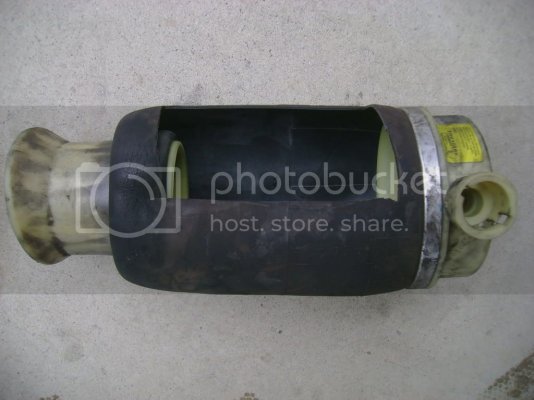

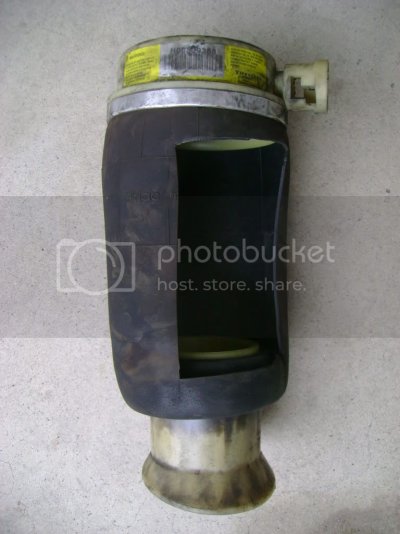

And while it took me 2.5 hours to do the whole thing, with the right tools this couldve been done in 30minutes. So before I tossed the bag in the trash, here is what they look like inside
