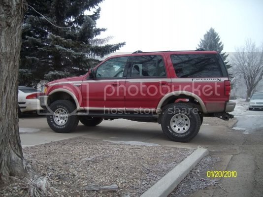

Thanks again, how much do those procomps run and about what would it cost just to lift it for the parts only? Could it be done without going to a body shop? Do you have any pics of your expedition that you wouldn't mind posting for me to get an idea of how it would turn out
Hers a pic of mine with the 3 inch Body lift, and 2 inch rear spacers and 2 inch torsion crank in the front. I have 315/75/16's which are around a 34.5 inch tire. This is before Gap guards, just so you can see the space in the rear.

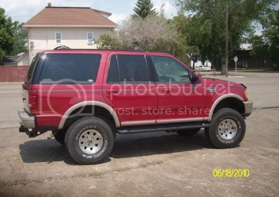

And with the gap guards...
The gap guards are pieces that go inside the wheel wells to prevent any debris from getting through, correct?

Mine are 8 inch rims, so they pretty much tuck under the wheel wells. Almost like a stock wheel. A 10 inch rim with similar backspacing will protrude out from under the fenders a bit more. Next set of rims I get will be 16 x 10's.
