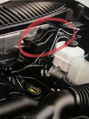

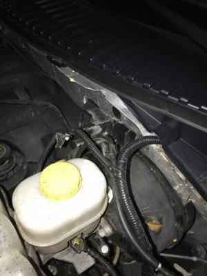

Hi, I am tryin to find that part ın the red circle(whic u can see missing) But I couldn’t find it. I hope you guys can help me about this.
My car’s brakes sign is always on.
I appreciateD

The circled red thing is above the booster is the vacuum reservoir for 4WD models. Won't be present on a 2WD.

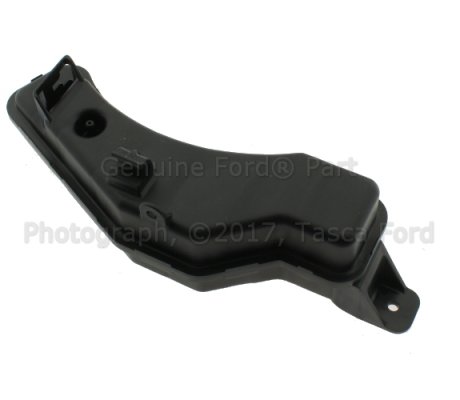

Ford part number is AL3Z-19A566-A
Here is an image from Tasca Ford Parts, where its $28
