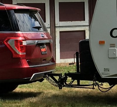

shane_th_ee
Aug 31, 2017
868
661
Seattle
It moves the ball (and trailer) farther aft of the rear bumper. When we picked up or trailer from storage this spring with our brand new expy, the old drop shank did not provide enough drop to level the trailer. The only shank available at my local RV store with enough drop was a 12" shank*. As you can see from the picture below (sorry for the crappy cropped cell-phone pic), the 12" shank moves the whole trailer farther away from the hatch. After towing with it for a season, I just replaced it with a normal 8" long shank. The longer shank had the following problems: it moved the pro-trailer backup assist sticker too far away from the bumper for the system to find the sticker**; as mentioned above, the leverage thing means it will move more weight onto the rear axle; also due to leverage the whole thing moves around more as it takes less force to move the hitch left/right or up/down and; it looks silly when the trailer's not attached.

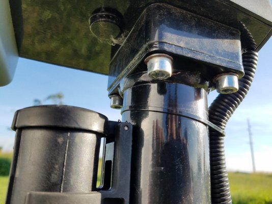

I went through this last year when I got sick of spinning the manual jack with my enclosed car trailer. Haulmark ships them with cheap ones I think is half the problem. After I installed my new Ultra Tow and hooked it up to my Expedition I realized the tailgate wouldn't open. WTH?!? After a little thought I looked close at the electric one and it looked like I could loosen four bolts and turn it around. That's what I did and it works awesome.
Old:
25726983378_d14d58ec8d_z.jpgIMG_20180109_091220240
New before turning around:
44550867892_1d02865051_z.jpg20180605_144758
New after turning around:
43691264245_52a2eaa2da_z.jpg20180625_192221
Carefully take these four bolts out and spin the housing around.
