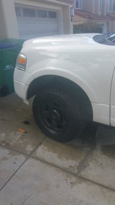

17" steelies are stock in barebones and gubmint trims for 3rd gen
Size is LT265/70r17
For ten bucks - $7 black plastidip, $3 tire shine - they look fairly passable....not great, but no longer entirely pitiful
