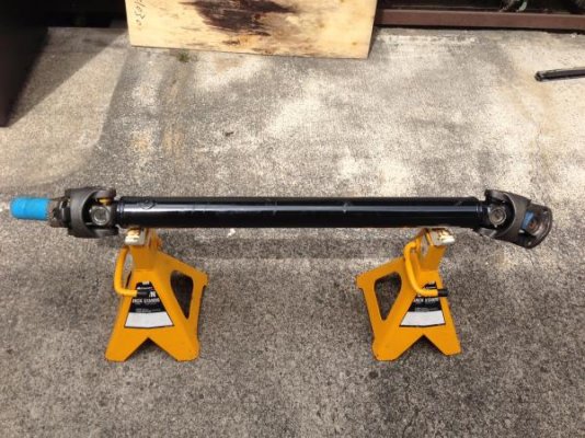

Has any converted to a Double Cardan driveshaft??
If so any issues?
I've heard that the weight of the Double Cardan joints on this style of transfer case (slip rear joint) can cause bearing issues????
I know Ford had originally put in this style of driveshaft but had recalled it do to problems (Vibes I think)
No issues. It actually made my ride much more quieter..
:head3:
That's a great looking driveshaft.....
I thought about the dual double Cardan, with 8" suspension lift the angles are not great.
But $$$$ :bawl:
Where did you get that????
mindgame
Sep 2, 2010
695
55
Honolulu, Hawaii
But $$$$ :bawl:
After getting the quote from Tom's and the shipping would have killed me, I shopped and work with a local DS shop specializing in Big Rigs. They were able to get the parts thru Splicers and we worked it out so an exact fit could be made for the Duals.. I think the cost was 400 or 450 I forget...
