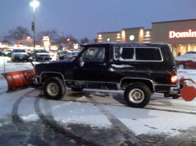

The difference between my setup and most plow guys is I run dual blades, front and rear. So I'm basically always running one or the other plow when I'm in a driveway and my driveways are close together so not a lot of recharge time. A lot of draw on the battery which I can notice after a while.

Here's my k5 I just got rid of. Backblade is custom build and so is the one that's on the expy.
