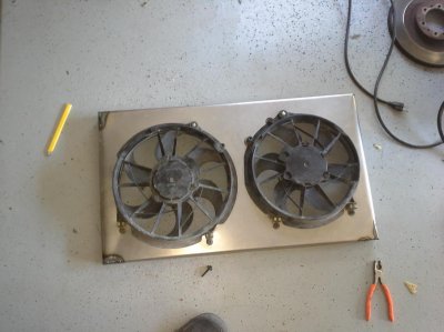

Albuquerque
Heres the shroud before I installed it
