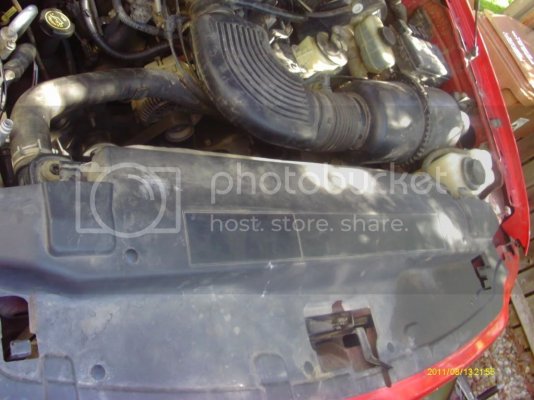

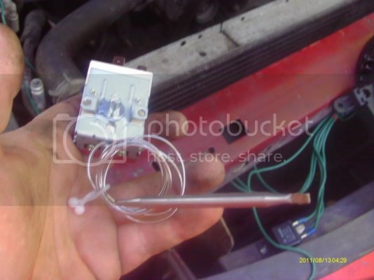

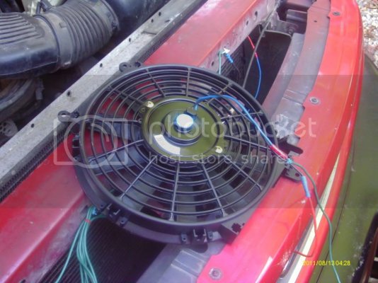

hey all sorry for the delay but here are the pictures..
#1 The 18" fan installed
#2 One of the 10" installed
#3 A better look at one of the 10" fan's
#4 The therostatic switch
#5 The relay's and switch installed
#6 Look at all the room with that big shroud and fan out of their
#7 The temp probe installed in the radiator
#8 All in all i think it is a clean install and frees up alot of room in the engine bay

i went with the slim pusher fans which are only 3" thick so yes their is plenty of room to mount your lights behind the grill.
