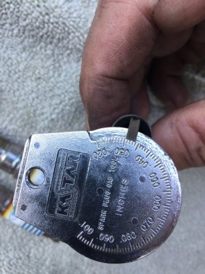

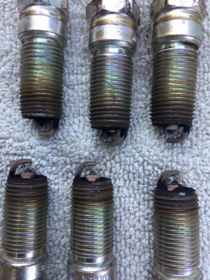

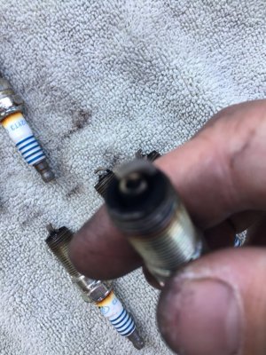

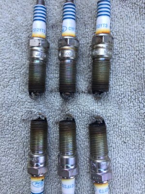

Just changed the plugs on my 2017 Ecoboost and couldn't believe at only 40k miles the gaps had eroded 5-7 thousandths and plugs were really carboned up.
Didn't bother going to the dealer to try and get warranty coverage as it was only $42 and 20 minutes time to install the Motorcraft Iridium OE replacements.
Can't believe how much better it idles now and bet my mileage goes back up again. From now on I'm replacing these iridium plugs every 30-40k miles.
