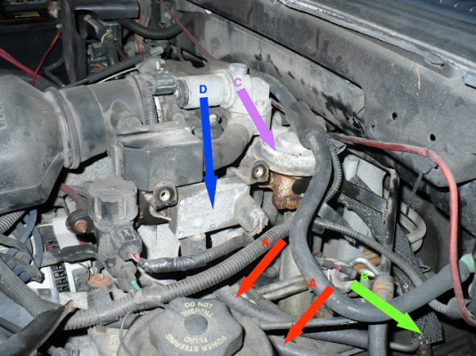

Ok here's a picture showing what I believe to be the related parts. Please correct me if I am wrong. This pictures shows the EGR valve with no vacuum port on the top. Please note that all the lines are black.
RED A is the hoses from the EGR switch to the EGR line
GREEN B is the EGR line
Lavendar C is the EGR valve
BLUE D is the EGR switch
Here's a little different angle

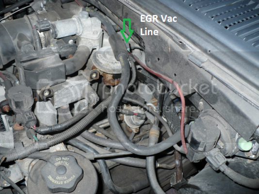

I was incorrect, the vac lines coming off the Vac Solenoid are green and white!
But this should solve your problem!

I'll be darned.... thanks! I moved the ********* line out of the way and presto!
I would not have thought the vac line would come out of the side like that, all the replacements come out of the center of the top. I would think it would suck on a diaphragm from the center. As long as the new style is the same, I'm in the game. Thanks again!
