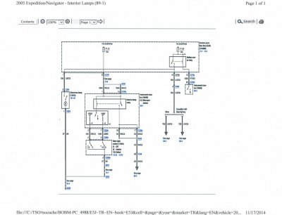

Bedrck47
Jul 4, 2014
5,639
659
Elizebethtown, PA
print
The battery saver relay is part of the fuse block and isn't normally user replicable. Although it can be replaced but that involves taking the fuse block apart
