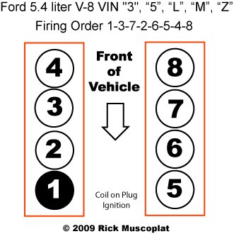

My 03 Expedition 5.4 With 189K started misfiring a few months ago, it was running rough, the Service Engine light would flash and a ton of codes came on at once including 301 and 307 so I figured plugs and coils. I replaced all plugs and coils with Motorcraft brand and it ran great for a couple of months. Last month it did it again, same codes, same cylinders misfire, so after asking a tech a the Ford dealer I replaced the ECU. So now with the new ECU I only get 3 codes 300, 301 and 307... but it is still misfiring and not running at full power. I replaced the coil and injector pigtails for cylinder 1 because the plastic tabs were broken, but still no change. What next, should I change fuel injectors?

What did you do to cylinder #7 ? You said you had a P0301 & P0307 . You worked on cylinder #1 , but what did you do to cylinder #7 to fix it's miss ?

Well, it's not worth anything on a trade in and really nothing to anybody with it's misfires. Anybody that does any research on the Ford 5.4 equipped vehicles knows the issue with the early 3-valve motors. So if the body is in good shape otherwise, you might want to just fix it and keep it yourself. At least you'll know it's been repaired and reliable. It's about $3k to have a shop do the timing set and oil pump. Tell your mechanic to use only Ford cam phasers, and the Ford or Melling high volume oil pump. Once repaired it should be good for another 150k miles. The bigger problem may be the passenger side overhead cam, if it's been the victim of oil starvation. If your misfire codes are consistently P0303 or P0304, and you've gone through the coil and sparkplug changes on those cylinders, you may be looking at a damaged cam already. But, you never know until it's inspected.
