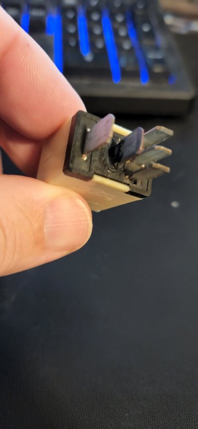

Is it still the original fusebox ? Usually that PCM relay burns, then the fuel pump micro relay ( it's soldered onto the circuit board...) fries, and your fuel pump dies. You can replace that relay, but inspect the fusebox contacts for burn or melted plastic as well. Keep a couple extra relays in the glovebox.

If it's the original one, replace it and keep the original for a spare. How many miles on your Expy ? The original will last 100k but after that, every day is a gift .... the replacement ones started using heavier duty Panasonic relays and had no problems.

You should get a little warning with that PCM relay burning up first ( carry a spare in the glovebox...). But as with everything in life, there's no guarantees. The '03s were really plagued by this, but the late production '04s don't seem to have it as bad. Maybe the revised fuseboxes were out by then. I can't remember.

I'd pull each relay and check them. If you see nothing on the removable relays, pull the entire Central Junction Box(CJB) and check the relays that are soldered in. When my fuel pump relay failed I noticed the burnt electrical smell around the CJB in the passenger side kick panel.
