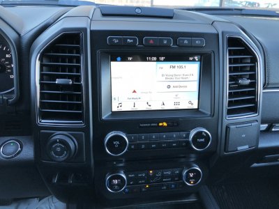

If you get the hd towing pkg, you get the two speed transfer case and lsd as well. If you want the 4l/4h option, you gotta get the tow option or the fx4 option.
That's not quite correct. This was a Limited 4X4 with the HD tow package but it did not have the 4L. It did have the locking rear differential.
Duh - Just saw it (1/23/18). I don't know what the hell I was thinking. Sorry for the confusion.:confused::confused::mad:
Here you can see the trailer steering assist on the dashboard.
